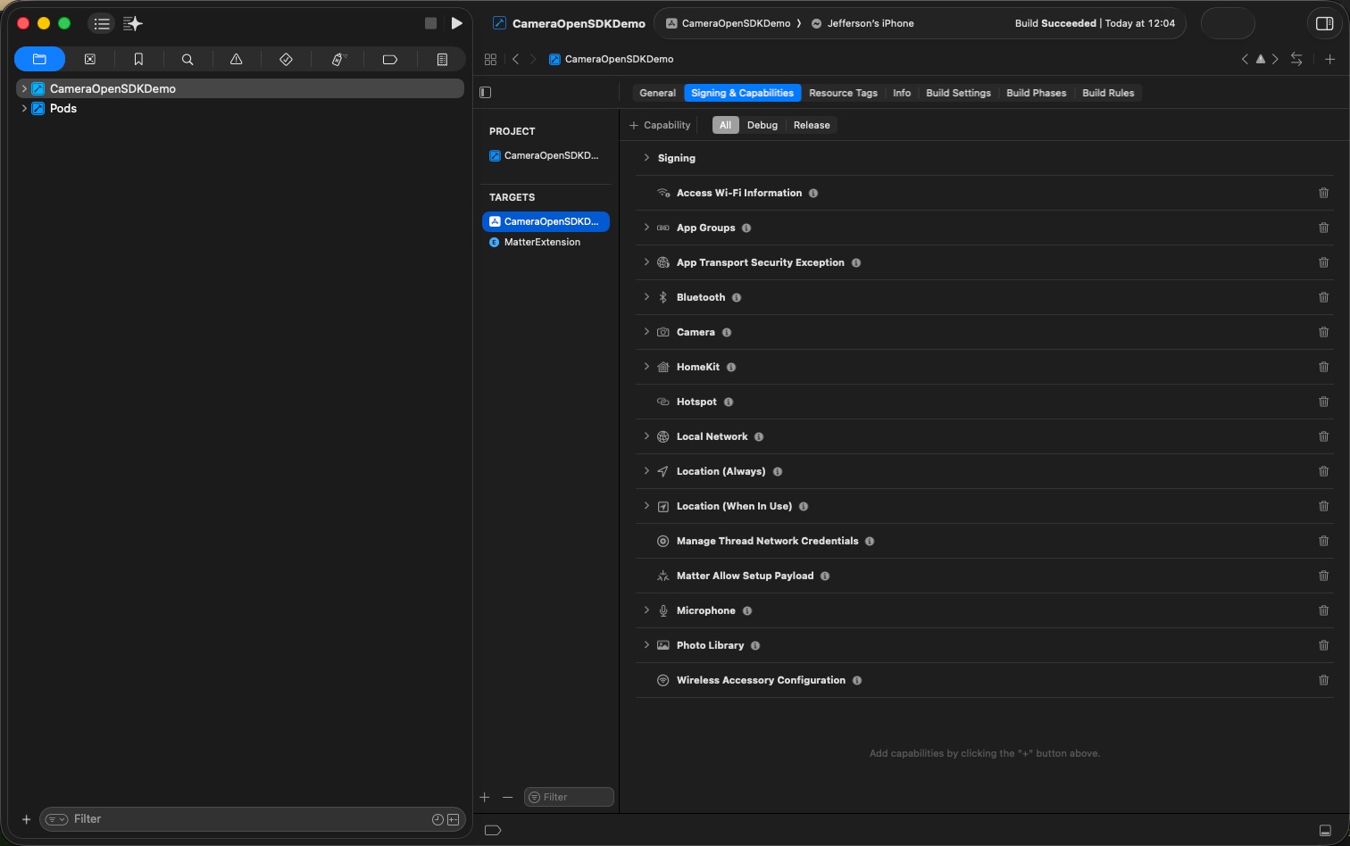

3.2.2 The Access Network SDK needs to add the following additional capabilities in Xcode:
Capability Entitlements Key
Hotspot com.apple.developer.networking.HotspotConfiguration
Access WiFi Information com.apple.developer.networking.wifi-info
Wireless Accessory Configuration com.apple.external-accessory.wireless-configuration

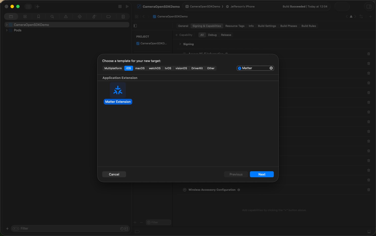

3.2.3 If the connected device is under the Matter protocol, Xcode needs to add the Matter Extension Target
iOS_CreateMatterExtensionTarget
3.2.4 The host app also needs to apply for the following capabilities in Xcode:
iOS_Host_App_Capabilities
Permission Entitlements Key
HomeKit AllowSetUpPayload com.apple.developer.homekit.allow-setup-payload
Matter Allow Setup Payload ccom.apple.developer.matter.allow-setup-payload
Manager Thread Network Credentials com.apple.developer.networking.manage-thread-network-credentials
App Groups com.apple.security.application-groups

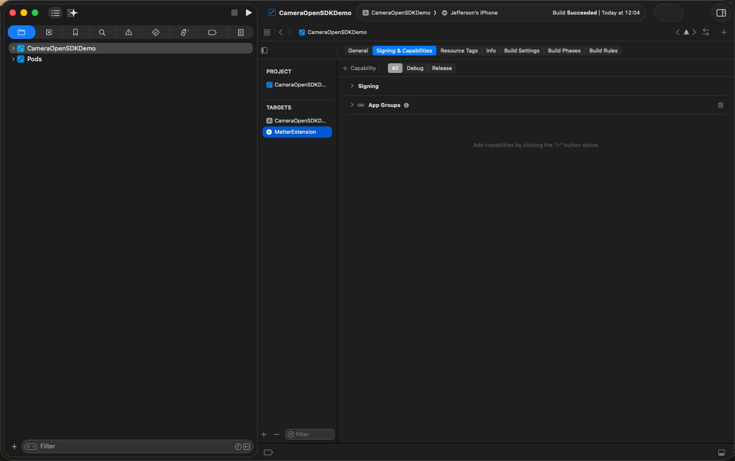

3.2.5 The Matter Extension also needs to apply for the following capabilities in Xcode:
iOS_Matter_Extension_Capabilities

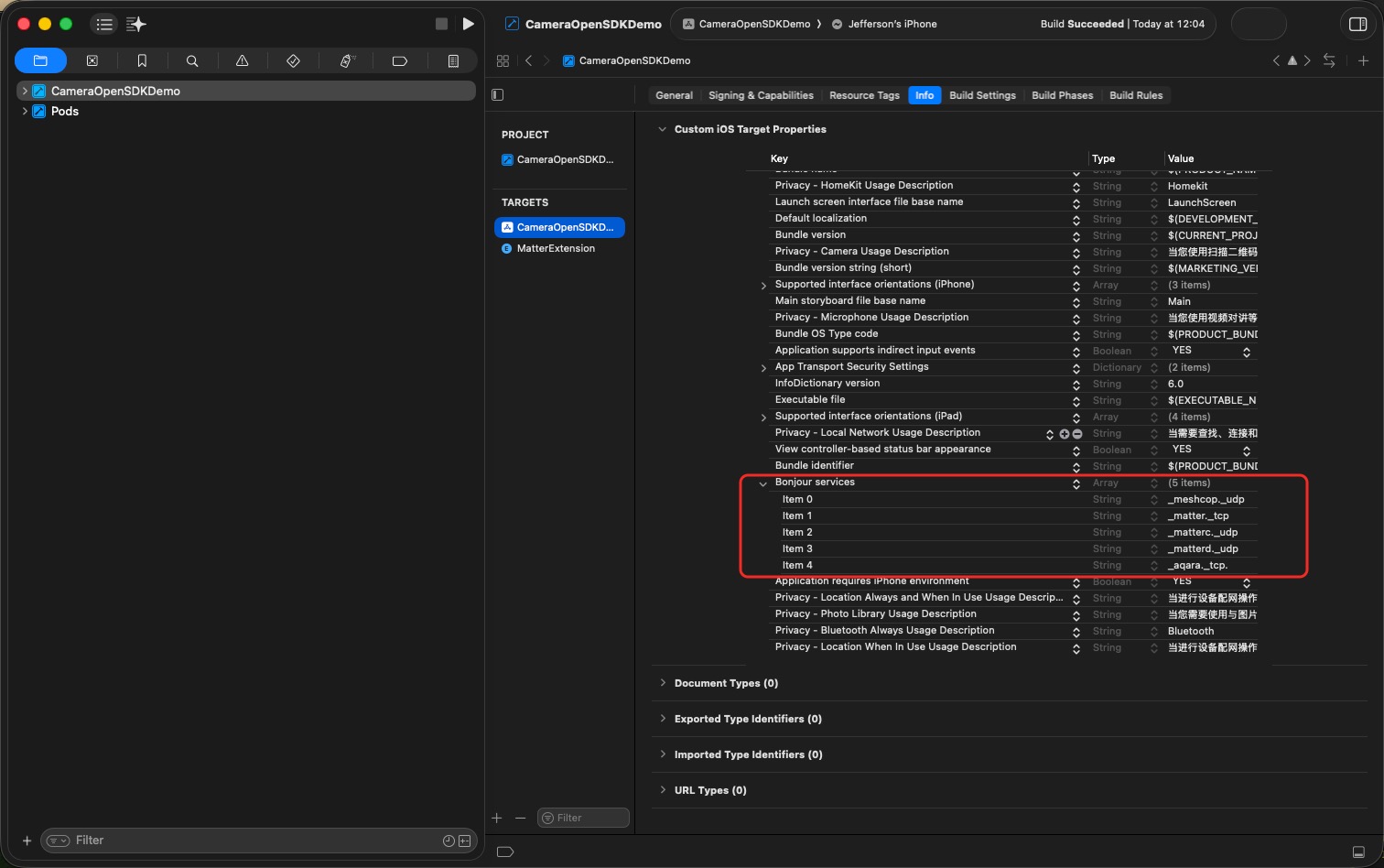

3.2.6 At the same time, the following key value pairs need to be added to the Info.plist of the host app:
iOS_Host_App_Bonjure_Service
Key Values
NSBonjourServices _meshcop._udp
_matter._tcp
_matterc._udp
_matterd._udp
_aqara._tcp.

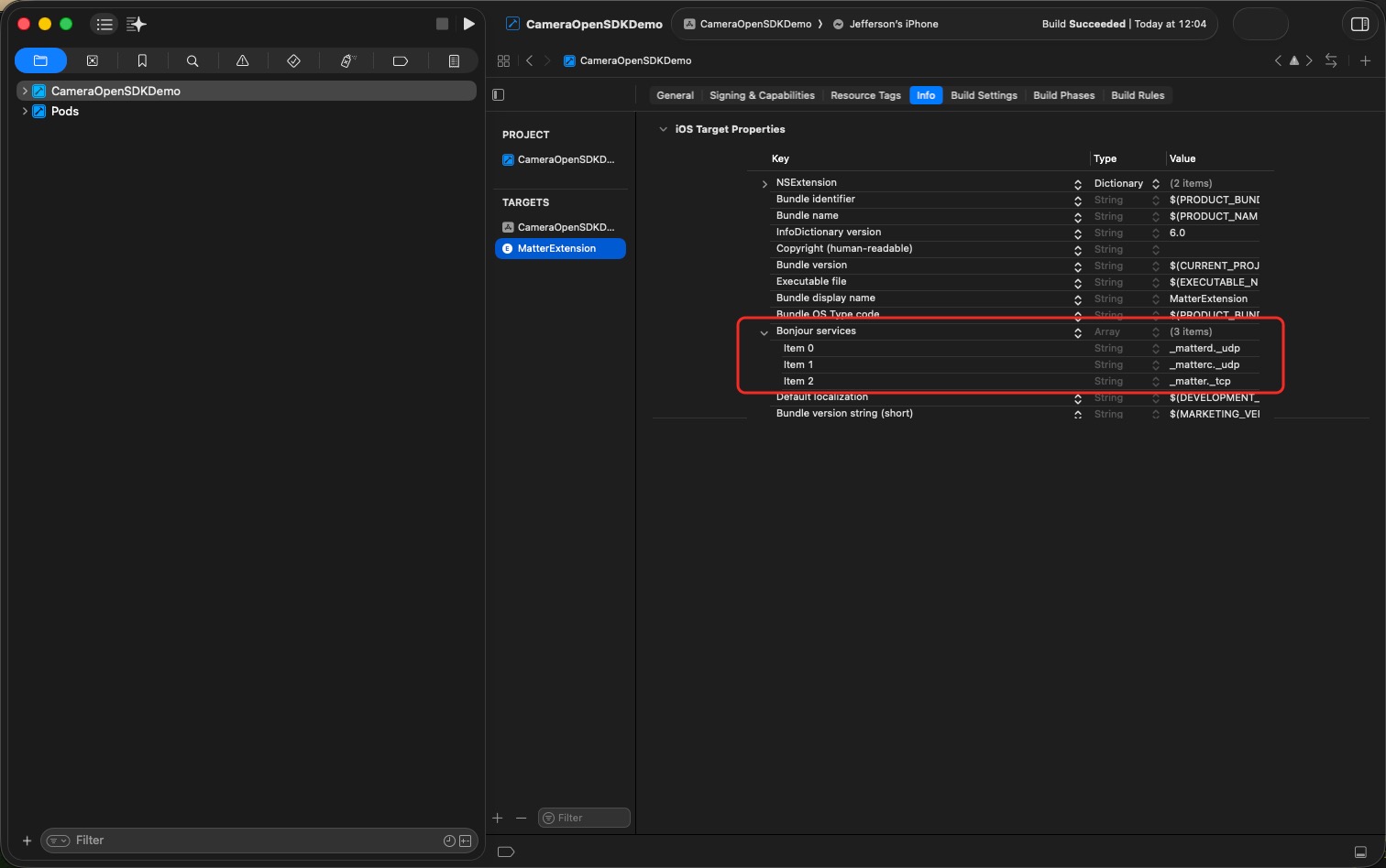

3.2.3.4 Add the following key value pairs in Info.plist of Matter Extension:
iOS_Matter_Extension_Bonjure_Service
Key Values
NSBonjourServices _matter._tcp
_matterc._udp
_matterd._udp
